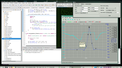

some news from the front
, ancien dev Intel, reprend "from scratch" le développement logiciel du MSA. Il ne s'agit pas d'un portage du Liberty Basic, comme c'était le cas avec l'actuelle édition du code en python (qui "fait sa job" comme on dit du coté de la belle province, mais qui n'est pas maintenu)
voici ce qu'écrit le gars
> Probably I'm the most advanced in writing from scratch Qt 4.x (4.8
> exactly) based version of msa talking to Scotty's hardware with (I
> considered also word "through" - that's major contribution of my
> native
> language) parallel port. Although gui is c++ all "backend" is utterly
> C, linux kernel like C in the opposite to various c-like things like
> misra and automotive zoo.
> I want to create git project hosted somewhere anyway I'm not sure if
> it is ready enough.
> Briefly described its features:
> - support for 1G band by now, others I kept in mind so it shouldn't be
> difficult
> - diagnostic mode including cavity test (tested and compared to
> genuine msa), dds sweep test and (new) dds1 and 3 phase test
> - spectrum analyzer,
> - vna transmission, including group delay and graph autoscaling
> - reflection is most interesting and not done yet.
> if we look at various utilities then there are available filter
> analysis and crystal analysis.
> I haven't completed L+Q (and C,R) measurement because my graph doesn't
> support log scale yet. Anyway this is of my interest too.
> I reckon that I have all calibration done, which are: RBW, frequency,
> line for vna and frontend for just "sa" mode. Done and results
> (verified) compared to genuine msa.
> So still hesitate if I should release it or just complete a few things
> before creating the public project.
> I also invented a wine shared library which glues "windows" lpt port
> to linux's ioctls to /dev/parport so it is possible to use genuine
> msa, liberty basic and wine together.
> Once upon I posted this project to this group and someone even
> promised to leave a feedback but he never did.
> Here is included an image of my msa showing results of one of McCoy
> filter tests I did once upon - verified with genuine msa of course.
> there is nice tooltip help also, settings window, eclipse with source,
> terminal window showing run time debugging.
> enjoy and if e.g. you success in (with ?) convincing me then I will
> release it.
> Thanks,

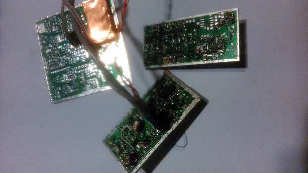

pour faire un peu de teasing, les photos de :
son support de modules taillé dans la masse
les trois cartes qu'il décrit ci-après
une capture d'écran du soft en construction
a propos du hardware, il écrit
"you may need to consider my in- house developed modules which are unique: iclkm, pdm-adc with cap bank
iclkm stands for "integrated clock module"
pdm-adc-cap-bank is stacked construction of two boards connected through 0.1" pins and for this connector there is rectangle hole in bottom right corner of the chassis.
Another story is a pdm module. I finally ended up with a conclusion that I should use smallest cpld to get what I want. Found Xilinx xc2c32 Two D flip flops (classic phase detector) approach were not enough because measurement is not ordered. The resulting voltage can show angle from A to B input or B to A and the switch tends to happen easily if there is xor gate so more Ds are required for proper syncing inverting signal and thus discrete Ds are "no go"
You can see on the pdm module test points to connect scope probes measuring phase shift between output from 8306 and reference input (mxr4).
I used dds1 and dds3 with 10.7M filters and my newly added "phase test"
to drive both inputs of combined pdm-log module with phase step of 11.25 deg."
Tant d'un point de vue dev, méca, électronique, ce type est un grand poète.

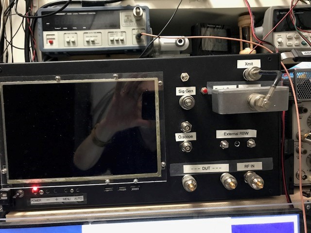

Bonjour à Tous,
Tout d'abord merci Marc pour toutes ces nouvelles. Etat des lieux de mon exemplaire du MSA : Tous les modules sont montés et testés (test individuel) avec succès. Il me reste à assembler tout ce beau monde et faire les tests globaux. Sur le plan soft, je ne dispose que de la version avec liberty soft et il faut que je monte un PC d'aplomb pour réaliser ces tests !
Claude F1OKU

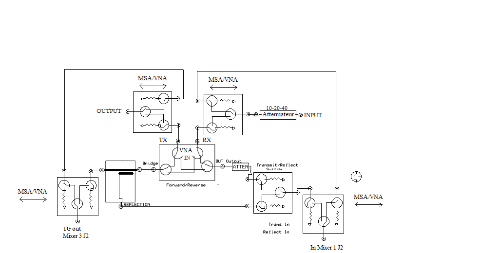

@ claude
je pense que l'inverseur de DUT, à l'instar des Agilent et consorts, ne sera pas intégré au MSA mais extérieur à l'appareil.
Les relais transfert n'ont pas assez d'isolation, surtout passé le GHz. Il faut une tête de mesure semblable à celle décrite par OZ7OU dans sont article "Test set for DG8SAQ VNWA version OZ7OU and Testresults T-Check results obtained"
... laquelle nécessite tout de même 4 relais coax strictement identiques et au moins 4 "U" en semi-rigide ou handformable qui présentent très exactement la même longueur électrique
et comme j'ai besoin d'une tête pour le N2PK (bien qu'il y en ait déjà une dedans), le vnwa et bien sur le MSA... autant qu'elle serve à tout le monde
ca va simplifier le schéma du routage d'entrée, mais nécessiter une prise "accessoire" un peu plus fournie que celle prévue à l'origine (alimentation, signal de déclenchement) et une électronique embarquée (tranformation du 5V ou 12V en 24 V, tranformation d'un signal stable haut ou bas en signal fugitif puisque ce sont des relais latch)
J'y bosse
